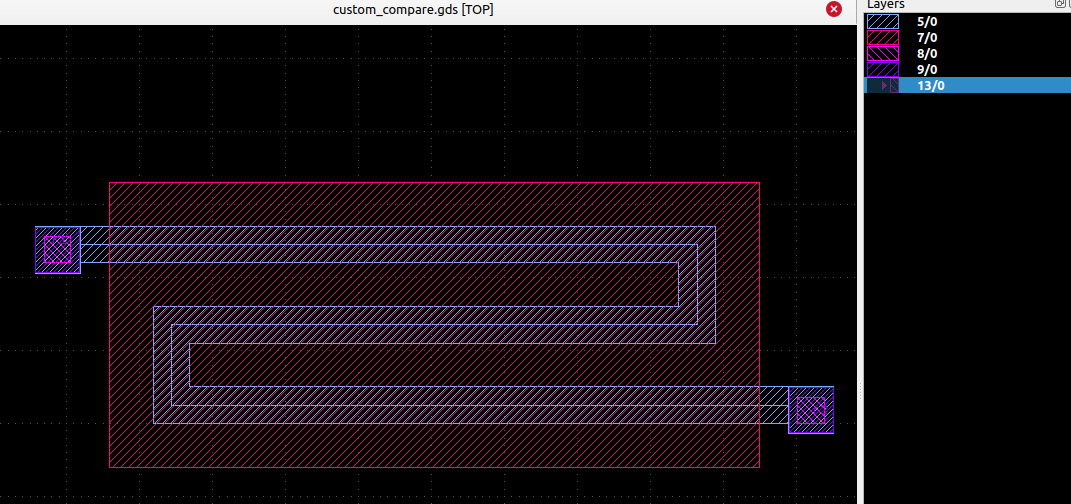

Hi Lidia,
the problem isn't the the connect statements but that you're using the entire M1.
I understand that "con" separates the M1 parts, but I do not fully understand your layout.
Typically you have a resistor marker which indicates the area where the metal (or poly etc.) is supposed to form a resistor. For poly resistors for example this typically is identical with a mask suppressing salicidation.
Like here:
In this case, layer 5 is "poly" and layer 7 is the "resistor marker" (polyres).
The corresponding LVS script is:
Please note that the conductive layer isn't "poly" anymore - it's the part of poly which is outside the resistor. So contact connects to this part, not to the original poly.
Coming to your question: supposed we had labels we wanted to attach to poly, it's important we do so by connecting the labels to "poly_not_res", not to "poly":
Otherwise you'd imply a connection across the whole orginal poly which would short the resistor.
