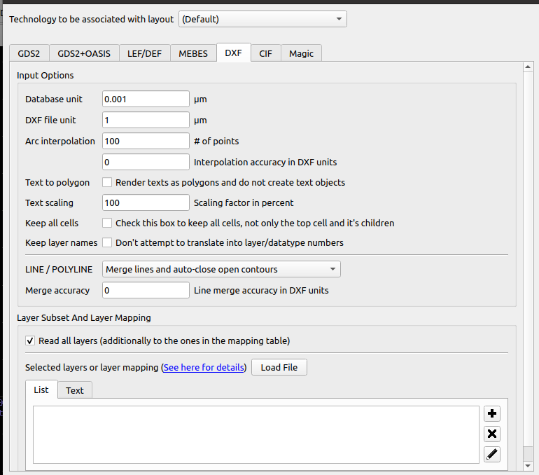

I was able to read this file with these settings:
You see I have used a DXF unit 1µm - so a DXF dimension of "1" corresponds to 1µm.
You are using a DXF unit of 1000µm which is 1mm. As your design's coordinates are in the range of ~4000, that would mean you're trying to represent a design which has a dimension of about 4 meters. Is that really true?
Anyway, this explains the coordinate overflow: with 32 bit coordinates (the standard build) and a database unit of 1e-4 (µm), you can represent a coordinate space of about -200 to 200mm. To represent 4 meters, you have to use a larger database unit (e.g. 0.01).

I did try the suggested settings, but almost all the smaller dimensioned elements get lost, and even some bigger ones get distorted. Is this fixable?
