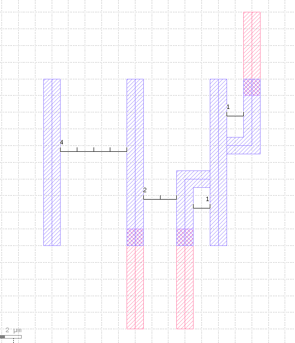

But here is a drc example that seems to do what you want:
As you can see the far right net is breaking the spacing drc (assume 2.5um min space)

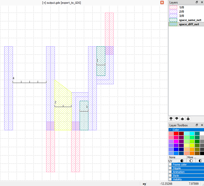

Here's the drc script:
After running the drc deck you can see the two different errors:
