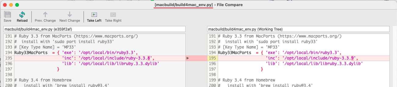

    Edit 2025-02-23:
    If you want to use the ./build4mac.py -q qt5macports -r mp33 -p mp312 build command (Fully MacPorts-flavored build), edit macbuild/build4mac_env.py as below.

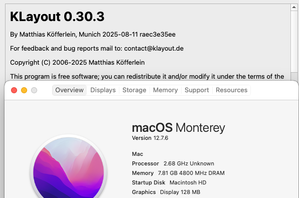

    To reconfirm again that the source code build in Monterey is still possible, I attempted the two builds for KLayout 0.30.2 with the latest MacPorts packages.
    1. 6A. Standard build using the OS-bundled Ruby and Python with MacPorts Qt5
    2. 6B. Fully MacPorts-flavored build with MacPorts Ruby 3.3 and MacPorts Python 3.12
    I uploaded two DMGs here for your reference.

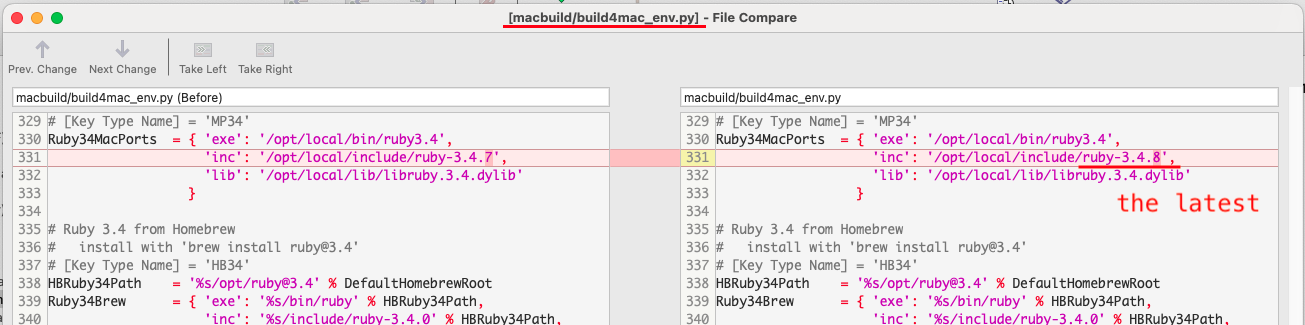

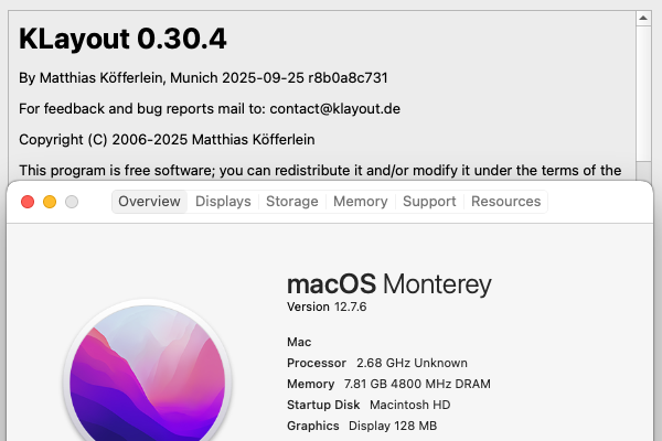

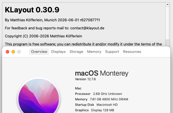

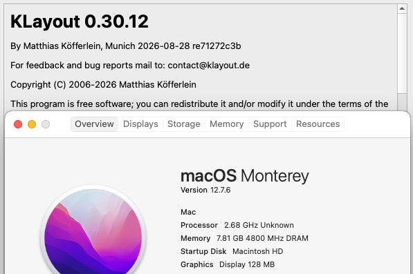

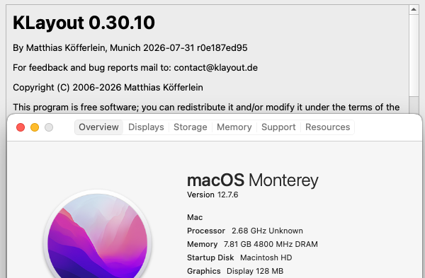

  • I have made another attempt to build version 0.30.4 on macOS Monterey (Intel).
    I have uploaded two DMGs for the community's reference, which you can find here.
    Unfortunately, the latest macOS version, Tahoe, no longer supports my 13" Intel MacBook Pro (2019 model).
    The machine's life is also nearing its end. :-(
    Kazzz-S

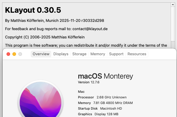

  • I made another attempt to build version 0.30.5 on macOS Monterey (Intel) to see if the overhauled build system for ARM64+Tahoe also works on Monterey.
    Kazzz-S

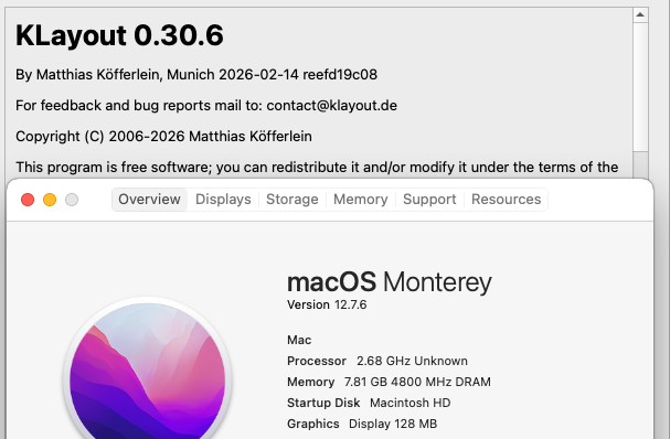

  • I've uploaded two Version 0.30.6 DMGs for the community's reference; you can find them here.
    Kazzz-S
