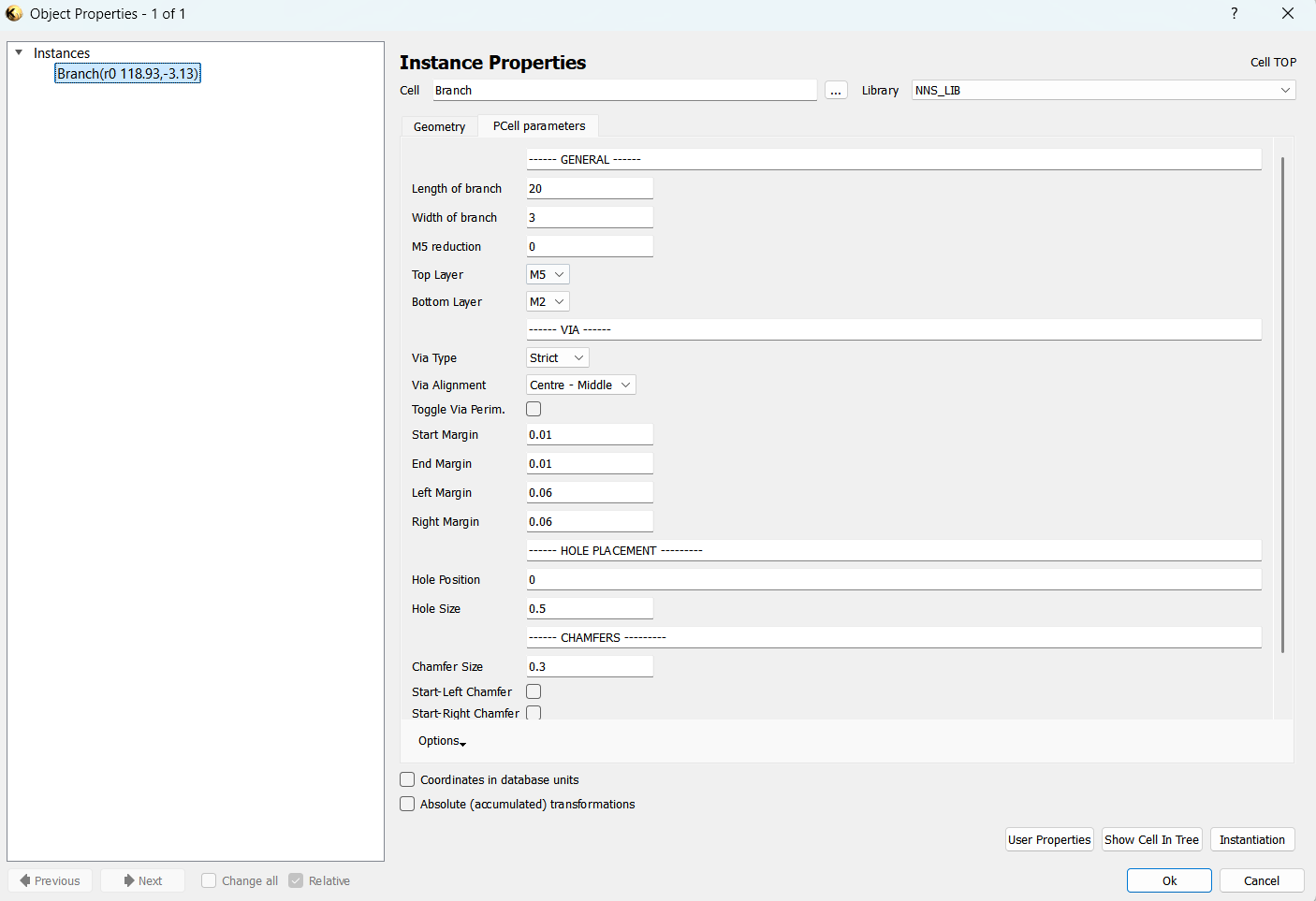

  3. Object Properties with custom positioning of PCell parameters
    • Currently parameters are displayed in a vertical sequence.
    • This is completely fine for the "Editor Options-PCell" view as it has to be narrow
    • But for wider views like extending the "Editor Options" view or in "Object Properties", there's much space unused, and it's a nuance to scroll down the list of parameters.
    • Proposal → Implement system to customize arrangement of parameters, be it HTML/CSS/XML style, table style, Qt injections, etc. Ideally it should be responsive to width changes, but horizontal scrollbar is fine (not so much for Edit Object narrow view, but that's on PCell developer, not KLayout's).
    • It would be also very useful to have some kind of built-in/intended delimeters, setting margins or proper labels to organize the parameters. Currently I'm using a readonly text field:
    • Of course sliders, images and other widgets would be much welcome too.
