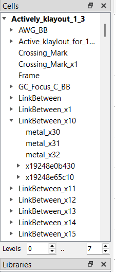

Here’s the structure of my test layout and what I’ve observed:
I have one rule that checks area, and it runs much slower in deep mode.
In my test, the deep mode runtime is about 375 seconds, while the default (flat) mode only takes 22 seconds — roughly 10× faster.

    My test layout has many cells, and each cell contains several subcells. From my understanding, deep mode should be more suitable for this kind of hierarchical structure.
    Is that correct, or does it still depend more on the actual layout patterns?
    I am trying to understand what types of layouts are better suited for deep mode versus flat mode, so I can choose the best approach for my DRC deployment.

    Hierarchical mode benefits from begin able to process things inside a cell once and then applying the result to all instances of a cell. That comes with an overhead which needs to be less than the gain and has limitations. Specifically, the operations need to be local. Boolean operations are local, but many operations are not. All operations that need to merge shapes are potentially non-local. If you have groups of polygons that merge into single ones and span over multiple cells, merging is a non-local operation.
