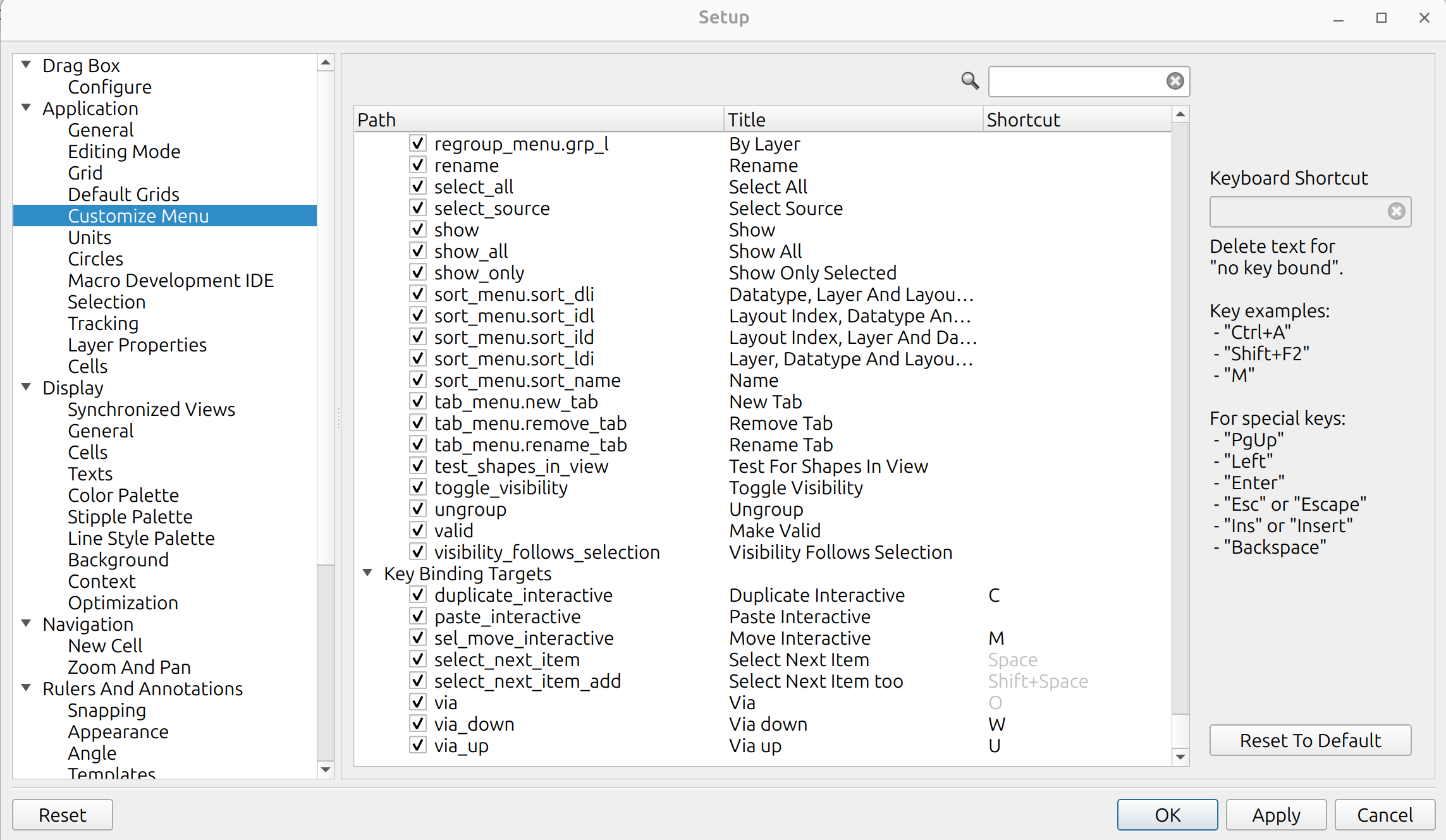

    Instead there is "Move Interactive". This is a function that cannot be put into the menu, hence it's only available as a key binding target. You find them at the end of the key binding options:
    You may like "Move Interactive", but you should also check "Duplicate Interactive" or "Paste Interactive". These functions enable "Cadence style" features. I bound "Move Interactive" to "M". That means, pressing "M" will start the move. KLayout will either use the selected objects or the highlighted one, if there is no selection. You place the object by left-clicking. So it's more or less what you ask for, but the "press" event is replaced by pressing the "M" key. This feels very intuitive and if you're a Cadence user, this pattern got etched into your brain anyway.
    "Duplicate Interactive" copies the highlighted object and starts moving immediately. I bound it to "C" for Cadence feeling. "Paste Interactive" finally pastes the copied objects like "Ctrl+V", but immediately starts moving, so you can drop the object(s) on the right place.
  • Hi Matthias,
    Thank you for the thorough explanation. I was guessing something like this would be the case, being the software as wonderfully curated as it is.
    "Move Interactive" does ease the workflow, although it's not perfect. You can use "Move" on objects without waiting for the object under the cursor to be highlighted. Not the case with "Move Interactive", but it already feels more seamless and "right" than before.
