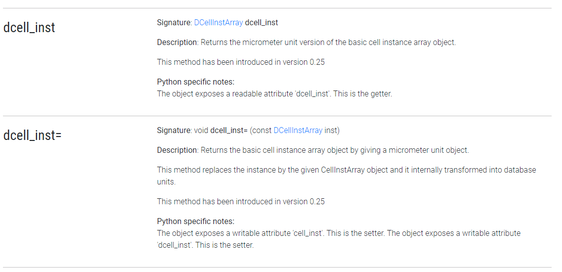

I use inst.dcell_inst to grep the info about array. And I would like to modify the array parameter (red square).
1. How can I do that?
2. What is the meaning of each value and how can i modify it? Thanks.
these are row/column vectors and array dimensions.
You specification translates into:
To change the properties of an instance, use:
