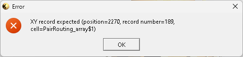

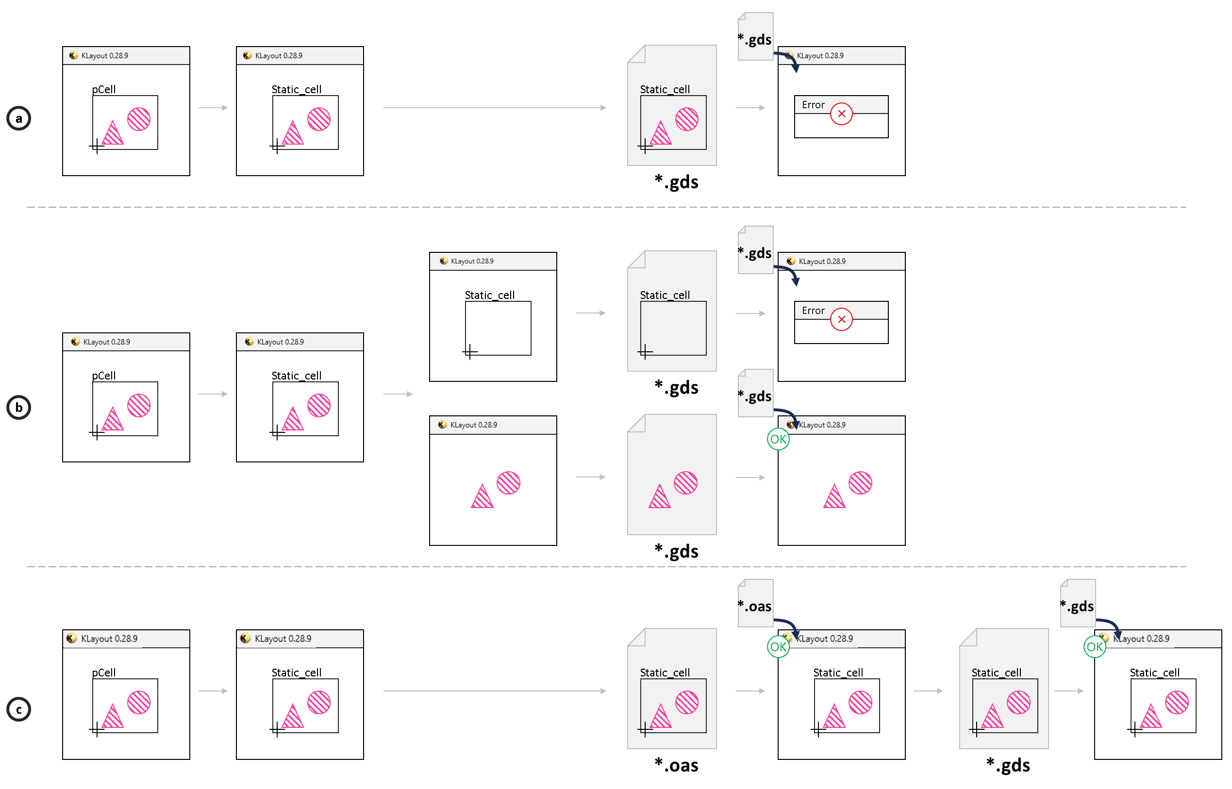

After flattening the pCells, saving the file, and re-open it, it sometimes
triggers "XY record expected error" image above (a)
It won't cause an error right after flattening and the file can still be edited if it's not closed.
For testing, I've tried to remove everything after flattening but the "empty"
file still causes the same error
The workaround is to copy the flattened shape to a new file and save the new file,
which no longer triggers the issue. image above (b)
This suggests the error might be bound to the cell instead of the shapes inside,
I assume this is why an "emptyCell" file can also cause the same issue.
Saving the file into OAS also solves the issue, but once you convert it back to gds, the same
error disappears. image above (c)

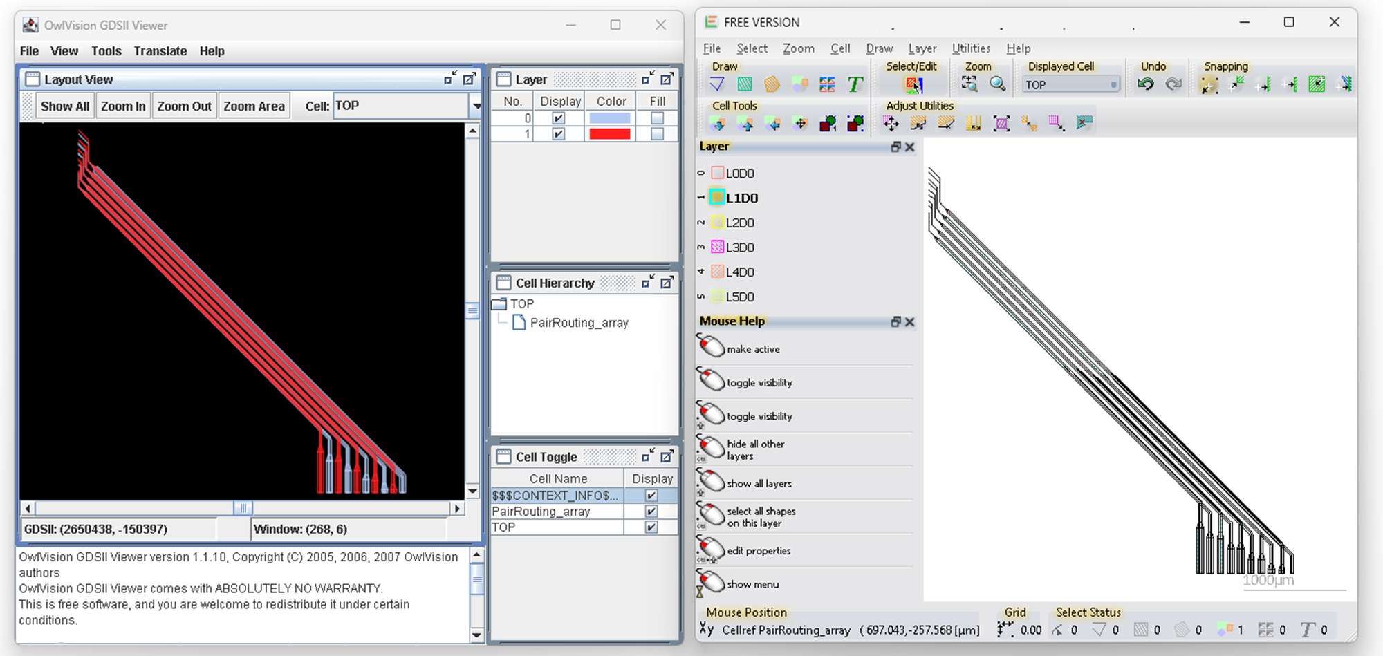

i've also tried and successfully load the gds files that generate error into other software,
the shape still holds, and the file is not corrupted.
