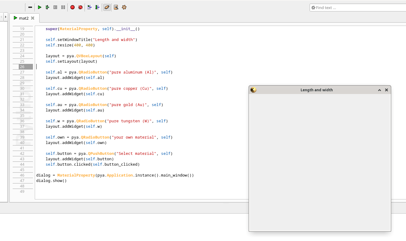

I have got a problem due to the Python GUI. The widgets (e.g. RadioButton, Label, LineEdit) are not shown in the GUI window. You can see, there is only an empty window. I tested this script under two Linux distributions: it is broken under Debian as well under Ubuntu.
But there are some funny things. Although the items are not visible, they are working. If you know where the button is, you can click on it's place and the connected code is executed.

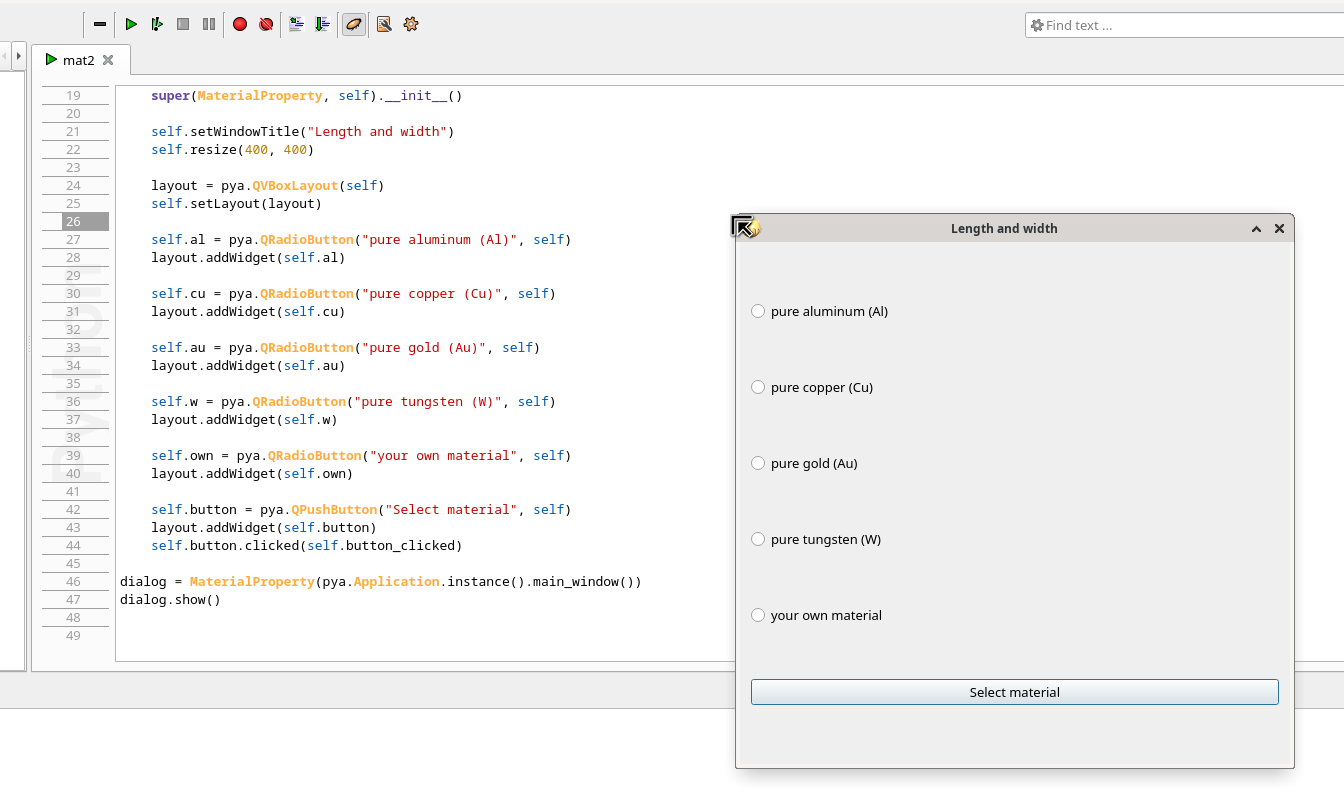

Another funny thing is, the widgets become visible, if I scale up or down the window. As long as I am pressing my mouse on the window's border, the widgets are shown. But if I release the mouse key, they disappear again.

Please try without Debugger on, i.e this button unchecked:
The debugger discards paint events. As it runs in the same event loop than the application, setting an event filter in Ruby or Python would otherwise make the debugger being captured in debugging into it's own events.
That is a basic limitation when the debugger is integrated in the application. A solution was to put the debugger into a separate process and let both communicate through some IPC mechanism, but I prefer spending my time elsewhere.
Thank you, yes this was helpful. I disabled the debugger, and now it works.
