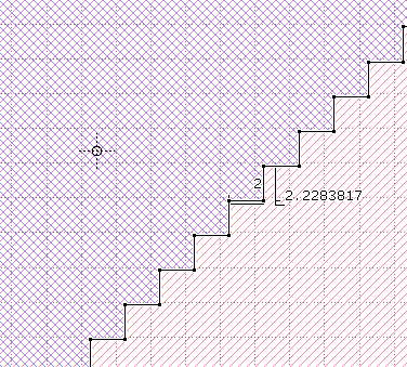

I get a question about how to modify polygons with multiple points.
Sometimes, layout needed to be simplified as some information take a lot of time to deal with when used in other simulation software.
For example, a polygon like this:
Stepped graphics takes a lot of time to deal with and those detailes are not very important in some cases.
1. So I want to get those polygons which have multiple points, maybe polygons with points >20 can be selected. Probabily those polygons are what we want.
2. Maybe I can calculate the space between the points of those polygons, if the space of two points are small, for example, 10um, then  I can remove those points, so the points can be reduced.
But i am not farmiliar with python in klayout. I have searched a example, but I don't know how to get the point number and points of a polygon. And how to search for the full layout, but this script seems to make function only when I have selected those polygons.

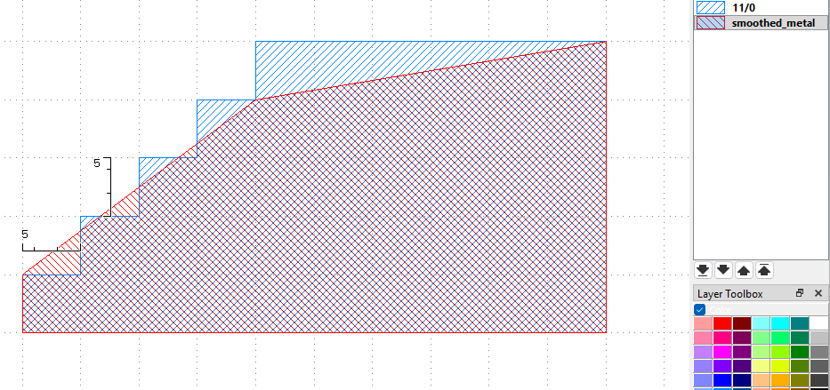

The 'smooth' function might be good to use. It removes a specified 'roughness' of shapes.
You can do this with the DRC engine here:
https://www.klayout.de/doc-qt5/about/drc_ref_layer.html#smoothed
Example
Or if you want a ruby/python implementation (good for applying to specific shapes):
https://www.klayout.de/doc-qt5/code/class_Polygon.html#k_91
Note: If you have geometries that have similar sizes as your roughness, then those will/may change.
My brain wants to believe I saw some other methods while digging through documentation a few months ago, but I can't recall...
Hope this helps, though.

It makes effect in an easy way. I can get an approximate pattern in this way.
