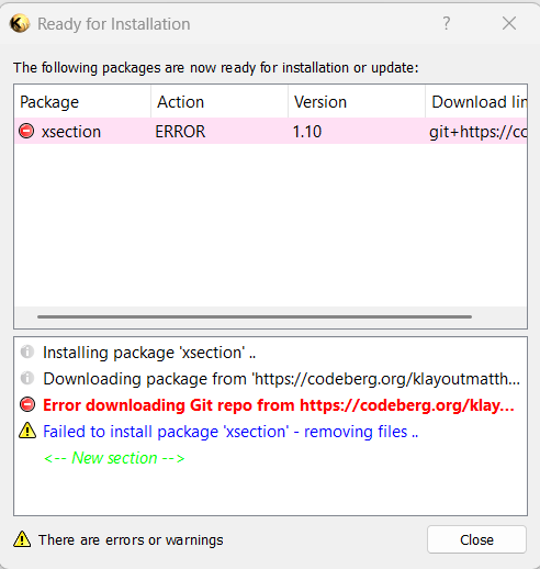

I have switched computers and needed to download Klayout again. This went smoothly for version 0.30.12. Next I have attempted to install the Ruby based xsection script 1.10. This results in "Error downloading Git repo from https://codeberg.org/klayoutmatthias/xsection.git (subdir 'src',ref")" What am I doing wrong?

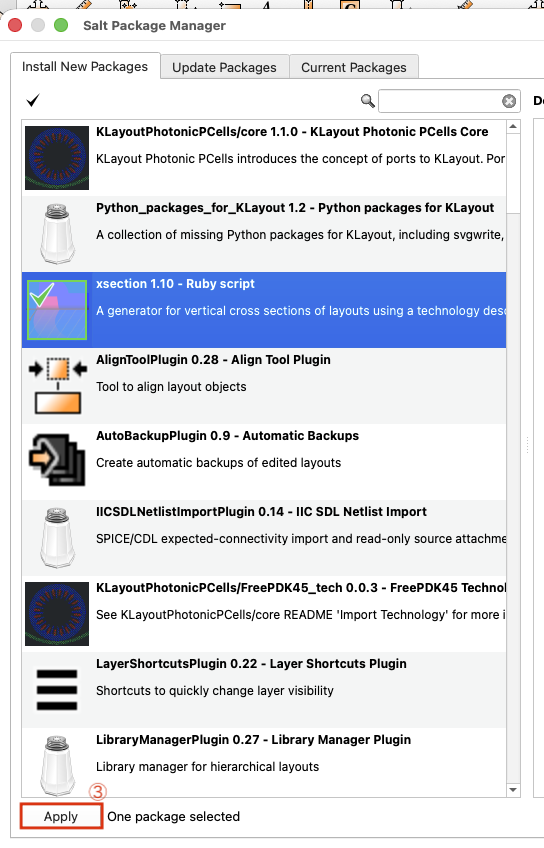

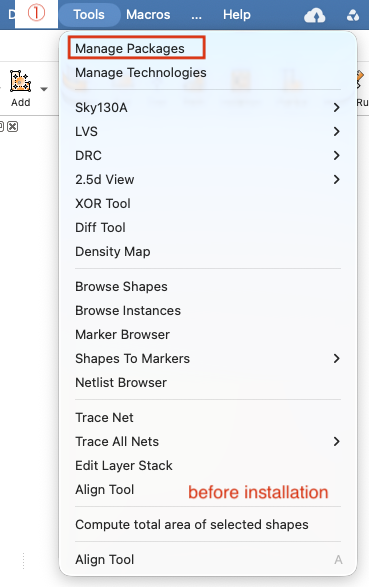

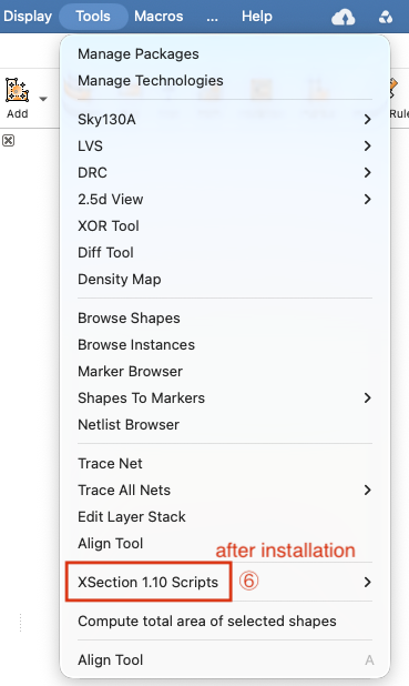

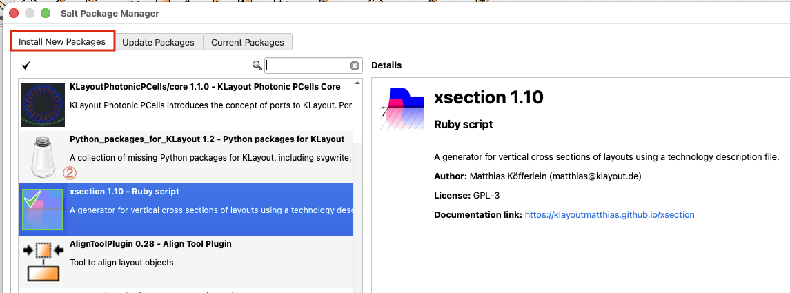

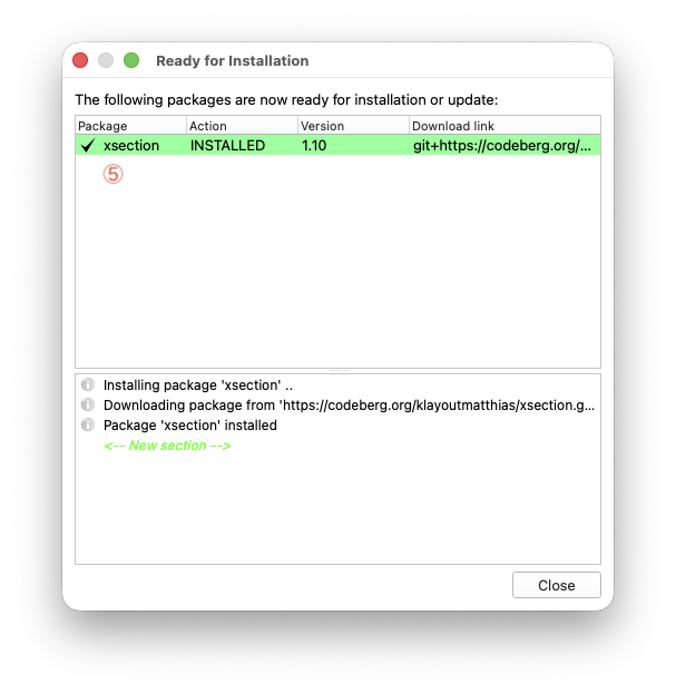

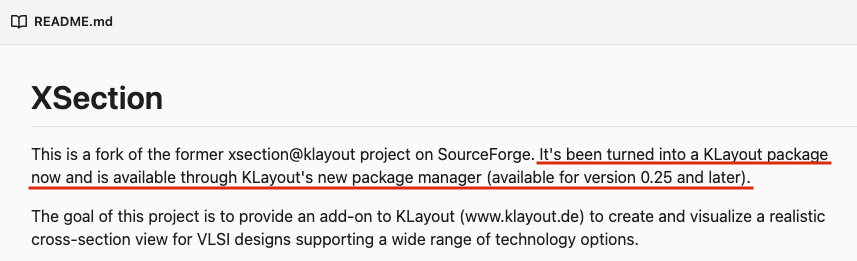

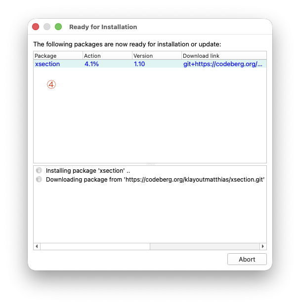

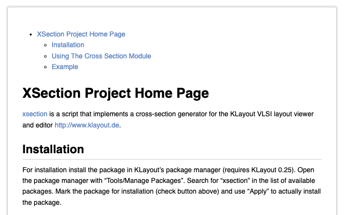

    As explained in README.md, we do not need to touch the raw git repository (https://codeberg.org/klayoutmatthias/xsection.git) if we simply use the package.
    Installation step

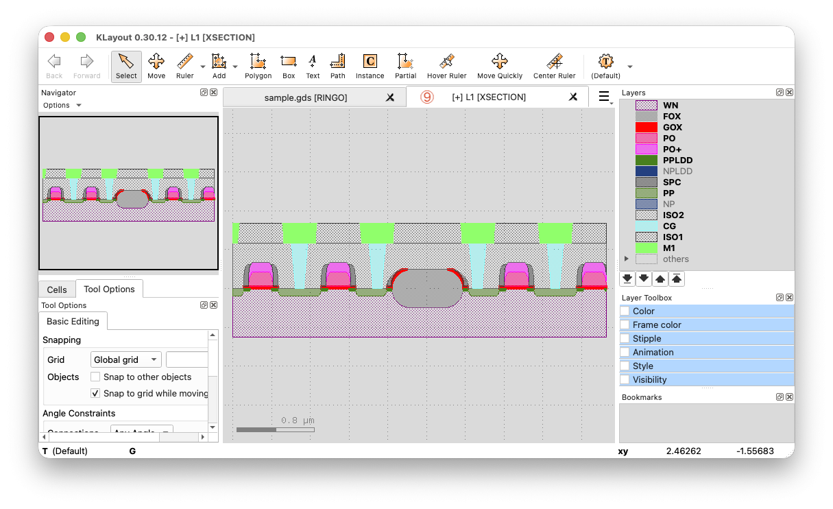

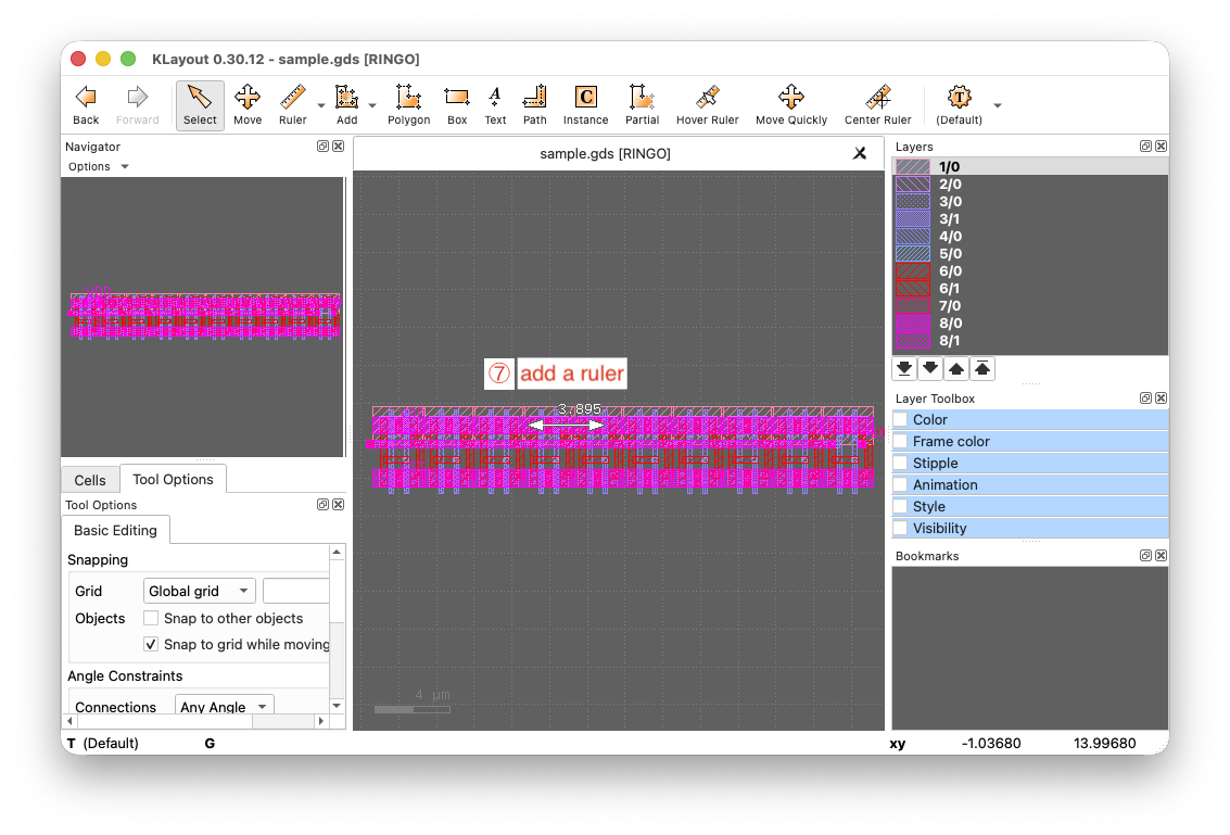

    Sample run

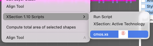

    When running a .xs script for the first time, select "Run Script" and choose the .xs file.
    The recent scripts are stored in $HOME/.klayout-xsection.
    sekigawa@ubuntu:~ cat $HOME/.klayout-xsection
    <xsection>
    <mru>/home/sekigawa/GitWork/ForumKLayout/Forum/Forum2890/cmos.xs</mru>
    </xsection>

  • I have followed your instruction previously and again after following your instructions.
    Seems quite simple but doesn't work. I have been using the cross-section tool for many years and have a number of Ruby process flows generated and don't want to lose that work.
    I have downloaded the www.klayout.org 1.0 - Ruby scripts with no problems using this approach.
